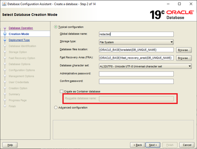

You would normally choose the Pluggable database name yourself, eg when using Oracle's Database Configuration Assistant. But if you left the form like this, I believe the database would be called either notcontain or orclpdb.
You can tell if a database is Container or Pluggable with a SQL Query like this.
SQL> select cdb from v$database;

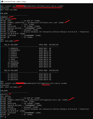

Can I determine the PDB name by looking at:
1. ArcGIS Pro database connection properties?
[Marcelo]: yes, the easy connect syntax "<server_name>:<port_name>@<service_name>
service_name = pdb_name
if using tnsnames.ora then look the details of your tnsnames.ora file to learn if it points to the pdb.
2. SQL Developer connection properties (JDBC)?
[Marcelo]: same as above.
3. A database query from a user/schema/owner connection (like PARKS, not SYS)?
alter session set container = cdb$root;
SELECT * FROM dba_pdbs ORDER BY pdb_name;
SELECT * FROM v$pdbs ORDER BY name;
SELECT * FROM dba_registry;
SELECT * FROM dba_registry_sqlpatch order by action_time desc;

See this screenshot with SQL Plus commands that you can use.
