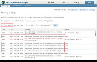

MiguelParedes
Greetings @PeterKT
If you want to record users accessing services, try "INFO".  Here is an example of logging output set to "INFO" showing access to the SampleWorldCities service/MapServer:
However, if you want to troubleshoot problems with the Server, then the advice from @MarceloMarques is the way to go, but "DEBUG" level, as @berniejconnors mentioned, should be used just during troubleshooting, since it has a detrimental effect on the server performance not to mention the large size of the logs produced.

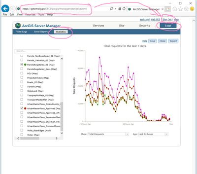

A_Wyn_Jones
@PeterKT
If you're looking for metrics on Map service usage; consider looking at the statistics menu in ArcGIS Server manager (pic borrowed from another thread):
You can create custom reports for specific map services and use this to improve map service performance and system optimisation.
https://enterprise.arcgis.com/en/server/latest/administer/windows/about-server-statistics.htm
https://enterprise.arcgis.com/en/server/latest/administer/windows/tuning-your-arcgis-server-site.htm
This can also be automated via python and REST:
https://enterprise.arcgis.com/en/server/10.8/develop/windows/example-export-service-statistics-to-a-...
https://developers.arcgis.com/rest/enterprise-administration/server/usagereports.htm
