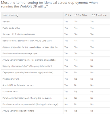

You may be running into BUG-000150335 The restore of federated servers with additional server functions may fail while the hosting server is being restored, which is fixed at 11.0. The restore of all federated servers, including the hosting server, start at the same time. However, there are internal operations that are called during restores, and those operations depend on the hosting server, (i.e. adding to trusted server lists, managing relational drivers, etc). If the hosting server is being restored and is unavailable, those internal operations may fail resulting in obscure errors. You may be running into that.
As for the hostname thing, the external/public URLs do have to be the same. If you take a backup from https://enterprise.domain.com/portal you have to restore to https://enterprise.domain.com/portal, but the internal machine names can be different. This has been the case since 10.5.1.
https://enterprise.arcgis.com/en/portal/latest/administer/linux/overview-disaster-recovery-replicati...
