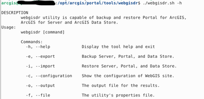

Here is the screenshot of the help command working just fine.

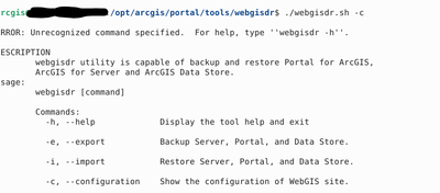

Followed by trying the -f with the webgisdr.properties file:
And for fun, here is the current configuration command:
Kind of maddening right?!
EdwardBuckley
I think I see your issue: you HAVE to add one of the -e, -i, or -c commands before the -f. You're missing them and only -h doesn't need it.

JVig
Sure, enough, that was the issue. Many thanks my man!
