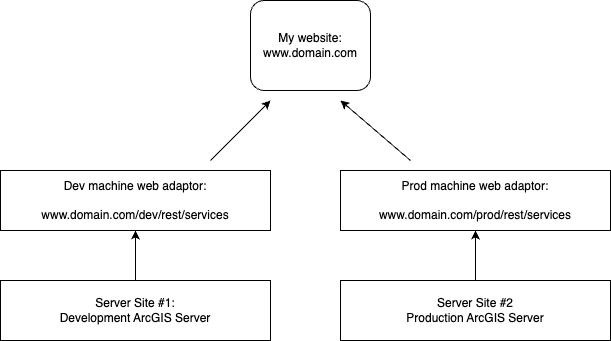

I'm trying to figure out if this is possible, and if so, is it advisable or is it better to have two separate web servers, one for dev and one for prod? I've been reading Install Multiple ArcGIS Web Adaptors and it sounds like one website can have multiple web adaptors, but the thing that isn't clear to me is that if each web adaptor can be pointing to different server sites or can multiple web adaptors only be used if all those web adaptors are pointing to the same server site? This is what I am thinking of doing, but can't figure out if it's possible (and advisable):

Hi @MKF62 .     We run nginx in front of our Esri web adaptors.   It provides a lot of flexibility.
I suggest adding nginx or another simple reverse web proxy for your use case.    A single nginx proxy will be able to route traffic to your two web adaptors, based upon the "dev" and "prod" paths, as you show in your diagram.
( from my point of view, your arrows are backwards, since IMO such arrows should reflect the direction in which traffic moves )
