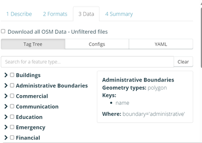

I was looking for a similar  OpenStreetMap data solution . I found this link "https://export.hotosm.org/" which contains osm data in multiple different formats.(Not sure what is the standard format for enterprise)
Moreover, it also gives the flexibility to filter the data by feature type (I believe we can check it depending upon the data we are interested in)
I need to create  street network data from OpenStreetMap data. Can you please guide me how should I proceed with it. what should be the standard practice?
How can I update the road network on the map regularly?
