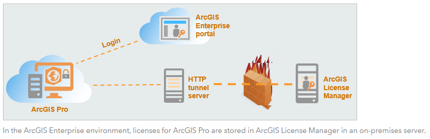

The set-up is that Portal and LSA is residing on different servers so according to the article: (ESRI) Named User the first call is made to Portal to see if the user is allowed to have a license and then to the LSA to actually check out a license, and then start Pro.
Does anyone know what kind of traffic that is generated to check with the LSA? For the first call to Portal it says it uses HTTPS.

In your situation, Pro makes two separate calls when starting.  Upon startup, it communicates to the portal through https.  You're know when you you get the login prompt to your portal.  Once you log in with a valid Pro licensed user, the portal will verify the user and determine what license(s) are assigned to the user.  It also determine where to get the license from.  Pro then makes another call to the designated license manager using the TCP/IP protocol.  This is likely where the failure occurs.  If you refer back to the article mentioned above by Scott_Tansley, https://desktop.arcgis.com/en/license-manager/latest/configure-the-arcgis-license-manager-to-work-th....  It walks you through the process to open your specific ports through your firewall.  Keep in mind there may be more than one firewalls between Pro and the license manager depending on your location.  As for the ports, the license manager uses two ports, 27000 for the lmgrd.exe daemon and any open port for the arcgis.exe daemon.  You set this up in the service.txt file as described in the article.  Then open those two ports through the firewall.   When troubleshooting, just verify communication to the license manager through those two ports are possible.
