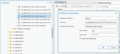

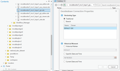

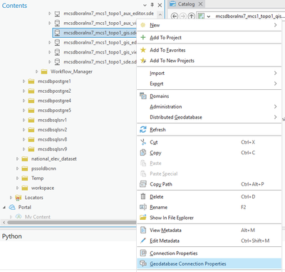

2. Geodatabase Connection Properties
Right click the geodatabase connection file
Choose "Connection Properties" - shows the database connection info
Choose "Geodatabase Connection Properties" - shows the geodatabase version info
These screenshots are from ArcGIS Pro but ArcMap dialogs are similar.
