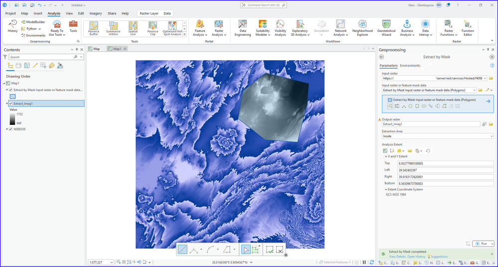

Hi @Jeff-Reinhart,
I just tried to run the Extract by Mask from ArcGIS Pro on an Imagery Layer in ArcGIS Enterprise 12 and I was able to run the tool without any issue
Might be worth reaching out to Esri Support for further troubleshooting

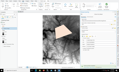

Hi @Jeff-Reinhart
I published a referenced imagery layer (PostgreSQL GDB) to ArcGIS Enterprise and the ran the tool of Extract By Mask and it ran successfully.
Perhaps it could be something related to data
