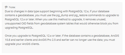

How To: Upgrade to PostgreSQL 12.x if the Database Contains a Geodatabase
  • Using pg_upgrade for upgrades to PostgreSQL 12:
    Using pg_upgrade for upgrades to PostgreSQL 12 and later is not supported if your database contains a geodatabase. The pg_upgrade utility detects the presence of tables created using the WITH OIDS clause and suggests an (ALTER TABLE) action to be taken on those tables. Because manual SQL changes to geodatabase system tables are not supported, use the method described in the solution section below when upgrading your geodatabase and upgrading your PostgreSQL database to version 12 or later.
Procedure:
Using pg_dump/pg_restore for upgrades to PostgreSQL 12
There are several options for creating backups of PostgreSQL databases. However, for PostgreSQL databases used to store geodatabases, Esri recommends you use pg_dump to create an archive file, drop the database, re-create the database with the same name, and restore to the re-created database using pg_restore. This backup and restore methodology can be used before or after upgrading the geodatabase to ArcGIS version 10.8.1 or ArcGIS Pro 2.6. You can upgrade directly from a 10.6.x, 10.7.x, or 10.8 geodatabase if your database is at a supported release for ArcGIS Pro 2.6 or ArcGIS 10.8.1.
