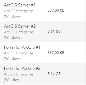

I am about to upgrade a testing environment from 11.2 to 11.5. I see two install files for download on My Esri for Portal and Server.
The larger files download as an odd file extension ".exe.001". Do the smaller exe work with these 001 files to install the upgrades as part of the workflow? I don't remember this file format going from 10.9.1 to 11.x.

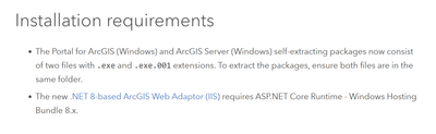

This was only included in the 11.3 documentation and not 11.4/5, although I think it should probably be included in all versions going forward because some people completely skip the 11.3 upgrade. Unless someone reads the 11.3 documentation, someone going from 11.2 to 11.5, such as yourself, would have never read about it.
 https://enterprise.arcgis.com/en/get-started/11.3/windows/what-s-new-in-arcgis-enterprise.htm

Thank you @RyanUthoff , that answers my question. I agree about including it all versions.
