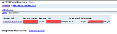

3.  Portal Sharing REST (i.e. https://portal.domina.com/portal/sharing/rest).  Log in and navigate to Home > Portal > scroll to the bottom and click Servers under Child Resources.  Verify the URLs are updated here:

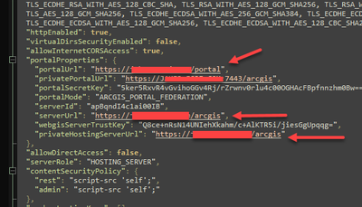

4.  On the ArcGIS Server machine(s), open the security-config.json file located at \arcgisserver\config-store\security.  Check the URLs are updated here:
