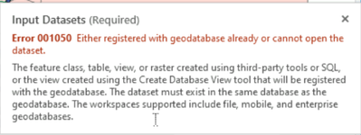

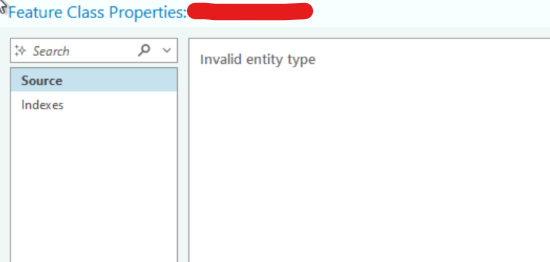

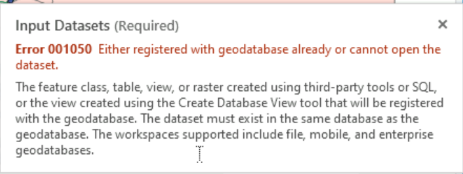

We're having trouble registering a feature class, created using FME with my Enterprise Geodatabase (SQL Server) so that ArcGIS Pro can recognize it as a valid geodatabase feature class.
When I try Register With Geodatabase or even open the Properties of the table in Pro, we are getting below error:
All the datatypes are valid and supported by SQL server and are aligned with ArcGIS. The table loads into SQL Server successfully and we can see the data as well.

  • “Register With Geodatabase” fails
  • Opening Properties gives Invalid entity type

I suspect there is a record(s) with invalid geometry and it fails when trying to register with the geodatabase.
What you might be able to do is register an empty feature class with the geodatabase first, then use FME (using the SDE writer) to write your records that way. If there is an invalid geometry, FME might tell you the specific record when Esri rejects it when attempting to write it.

ArshiyaNisa
Hi @RyanUthoff
Our first record on table has geometry issue, hence pro was unable to register the feature class with GDB. Thank you for your time.
