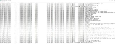

We are using ArcGIS Enterprise Varsion 10.7.1 with ArcMap 10.7.1 and Pro 2.6. We Created an addresss locator using pro which is not able share with enterprise. But the address locator created withArcmap can be  published successfully. Publishing other services from ArcGIS Pro to Enterprise working without any issues.
We have tried to validate databse, register folder, Change arcgis pro version higher and lower. Nothing worked. Any Idea how to solve this issue.
Garowe_Address_locator 6 Locator ArcGIS Enterprise https://xyz.com/server admin 2024-12-22 23:00:46 Status: InProgress StatusMessage: ERROR 001369: Failed to create the service.
Garowe_Address_locator 6 Locator ArcGIS Enterprise https://xyz.com/server admin 2024-12-22 23:00:48 Status: InProgress StatusMessage: Failed to execute (Publish Service Definition).
Garowe_Address_locator 6 Locator ArcGIS Enterprise https://xyz.com/server admin 2024-12-22 23:00:48 Status: InProgress StatusMessage: Failed at Sunday, December 22, 2024 11:00:40 PM (Elapsed Time: 0.14 seconds)
Garowe_Address_locator 6 Locator ArcGIS Enterprise https://xyz.com/server admin 2024-12-22 23:00:50 Status: InProgress StatusMessage: Failed.
Garowe_Address_locator 6 Locator ArcGIS Enterprise https://xyz.com/server admin 2024-12-22 23:00:52 Status: InProgress StatusMessage: Failed to execute (Publish Service Definition).
Garowe_Address_locator 6 Locator ArcGIS Enterprise https://xyz.com/server admin 2024-12-22 23:00:52 Status: InProgress StatusMessage: Failed at Sun Dec 22 23:00:42 2024 (Elapsed Time: 3.10 seconds)
Garowe_Address_locator 6 Locator ArcGIS Enterprise https://xyz.com/server admin 2024-12-22 23:00:54 Status: InProgress StatusMessage: Failed.
Garowe_Address_locator 6 Locator ArcGIS Enterprise https://xyz.com/server admin 2024-12-22 23:00:56 Status: InProgress StatusMessage: Server-side publishing failed
Garowe_Address_locator 6 Locator ArcGIS Enterprise https://xyz.com/server admin 2024-12-22 23:00:58 Status: InProgress StatusMessage: Publishing tool execution failed
Garowe_Address_locator 6 Locator ArcGIS Enterprise https://xyz.com/server admin 2024-12-22 23:01:00 Status: Failed ErrorMessage: Failed to publish locator.
