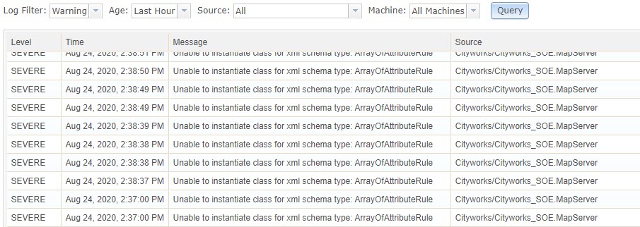

This SEVERE level log keeps popping up for a service that doesn't have any Attribute Rules applied to it. I've been able to fix the issue on other services that do have attribute rules applied in ArcGIS Pro. However, this one does not. It even crashed the server a couple times because it came up so frequently in the logs. Anyone else run into this error before?
