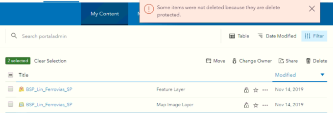

Hi,
I was published some features in Portal. I have Server federated with Portal.
I created Server conection in Arcmap and publish de feature for tests.
Now I need remove the item from portal. I was deleted from Server with success. But from portal the messagem below appear.
The user used to publish: The server admin
The user logged in Portal: Administrator.
Why I can´t to delete the item from Portal?
Thank´s
André

JakeSkinner
Esri Esteemed Contributor
Hi Andre,
The Feature Layer is dependent upon the Map Image Layer.  Try deleting the Feature Layer first.  If this is successful, then try deleting the Map Image Layer.

RenatoTeixeira1
Hi Rachel,
Thanks for trying to help, but reindexing does not delete the orphaned Portal items.
I am using ArcGIS Enterprise 10.71, and the only way is to use force delele, manually item by item.
ErwanCaradec
Hi,
i encountered a similar issue after transferring content to another user:
the transfer failed because the destination user did not have management permissions on a group the item was shared with.
After that, it was impossible to access the item’s detail page or delete it because the option “Prevent this item from being accidentally deleted” was enabled.
The root cause was that the bulk deletion process removed the folder but not the items inside it.
Solution: move the item to the user’s root folder, uncheck “Prevent this item from being accidentally deleted”, then delete the item.
