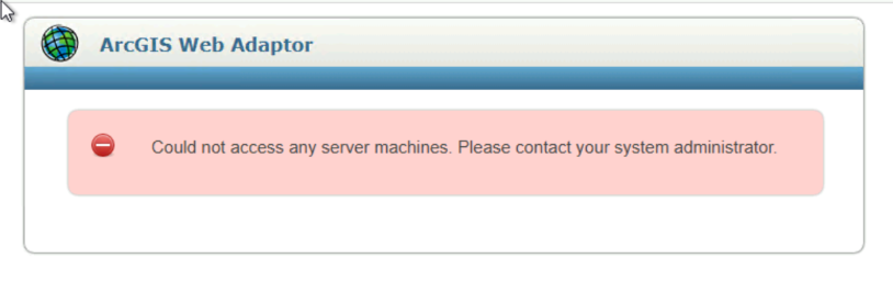

We have a standalone server which is not federated to Portal. The server was working fine till yesterday night and today when we are trying to open the server manager/ rest end points the server is not accessible. We had a scheduled Windows update done on the server.
Today when we are trying to access server manager/rest end points, we are getting the error as-
We have checked logs. It says RMI Registry is not running on port '1099'. And most errors relate to java.rmi.
