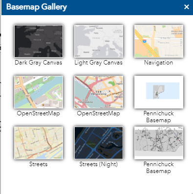

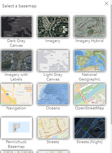

I have a curious issue with the Esri basemaps in my Enterprise web apps in 10.8.1. When I add a basemap switcher widget, I only see a selection of the Esri basemaps. Everywhere else (web maps, dashboards, etc) I see this in the basemap gallery:
In web app builder, I see this in the basemap widget:
I'm not sure what's going on with those duplicates, either. Anyway, when I look at the developer console in my browser, I get the error :

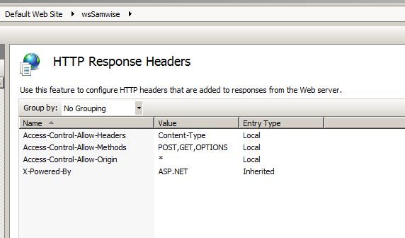

Have you checked in IIS ? the allow origins set to * in http response headers section
JCGuarneri
Hmmm.... I don't have that parameter set to anything. The only parameter I have set is X-Powered-By. I tested on my dev portal, and it works there. The HTTP Response headers are set the same. The biggest difference between the two portals is that dev is on 10.9.1. I'll also have to double-check whether the SSL certs are set up the same.
