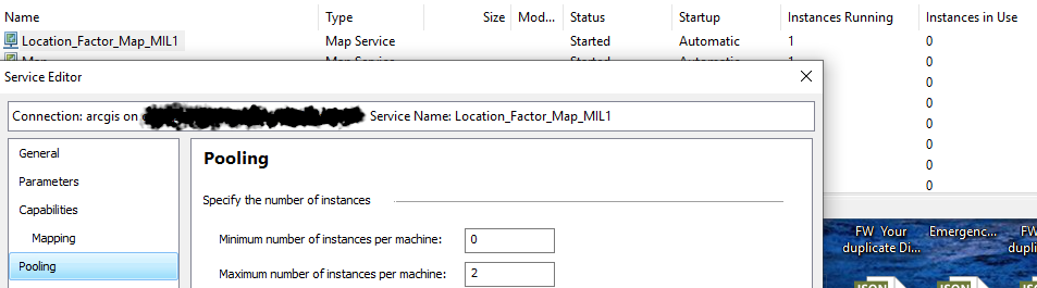

We are running ArcGIS Server 10.6.1 and are having some performance issues.  We are experiencing heavy memory consumption that I'm thinking is attributable to a high number of ArcGIS SOCs running.  I am trying to fine tune the services and would like some help in really understanding what happens after I publish a service.
When I connect to the ArcGIS Server in Catalog and view the services, there are two columns referring to the number of instances for a particular service: "Instances Running", and "Instances in Use".
1) What is the difference between these two columns?
2) Which column is related to the ArcGIS SOC created on the server?
3) Even if I set the number of minimum instances running to 0 there occasionally is still "1 Instances Running" but "0 Instances in Use" why is that?
4) In my simplistic nature, I assume the more heavily a service is being requested the more instances I need to have available?
5) In a scenario where a user has a web map open but the layer is turned off, is that layer still requesting an instance or not?
Any help in deepening my understanding of this process to help my end users and adjust for performance gains would be greatly appreciated

Although pooled instances changes this at 10.7.1, 10.6.1 will simply use the n +1 recommendation where n equals the total number of cores on your machine.
So if I have 4 cores on my machine and I know a service will encounter heavy traffic, I would set the maximum number of instances to 5 for optimal performance.
Also, if I know a service is not going to need as many resources, I can set the minimum instances to zero so that there are no ArcSOC's spun up but not being used.

Just to clarify so if I take your example of spinning up 5 instances will that also spin up 5 ArcSOCs?
AndrewWhitman1
Heath,
That is correct. Now keep in mind the design of this changes at 10.7 and above but at 10.6.1, this is precisely how it should operate. Instances correlate with ArcSOCs. If you are on Windows, you can just open task manager and get a sense of how many ArcSOCs are running.
