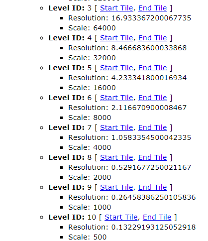

We have successfully created the cache in the test environment have attempted transfer the cache over to the production environment. We created the identical service on the production environment and then transferred the cache over into the correct folder and directory which all went to plan. We then restarted the service and checked the rest end point it shows all the relevant scales as can be seen below.
Rest End Point Scales

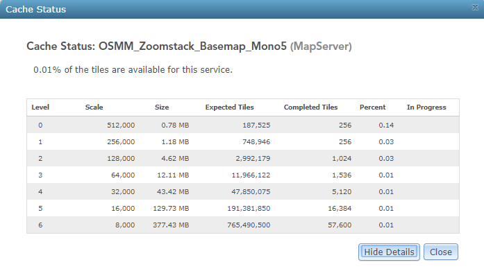

However in server manager in the cache status report it comes back listing only some of the scales up to 8000 that have been cached. After we go to view the cache we can browse to it up to scale 8000 and then we go any lower all the tiles are grey and not coming through even though all the scales are in the cache directory
Cache Status

I do not see something incorrect with your process, the first scales do work also for you new service in the prod ArcGIS Server. You mentioned that all the scales are in the cache directory beyond scale 8000, did you also confirm that the directories for the problematic Level ID's contain the exact number of files as the test server where they were generated? And while there you can verify that the ArcGIS Server account has at least read/write permissions on those directories.
If all the above appear correct, then it's possible that there is a corruption in the status.gdb file geodatabase where the cache status is being read from. You may try deleting the status.gdb (either with a Desktop tool preferably, or directly from Windows Explorer), and then run the Cache Status report from the Server Manager (as in your screenshot above) to generate it again. If it completes and reports 100% of tiles then it was a corruption of the initial status.gdb.
