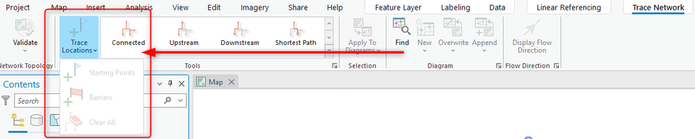

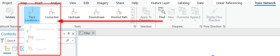

I want to publish a trace network service, I have tried creating the trace network and it was working properly, but now I am facing some issues, after executing the "Create Trace Network" tool, when I try to set the starting points, that tool appears "blocked"starting_points.pngstarting_points.png

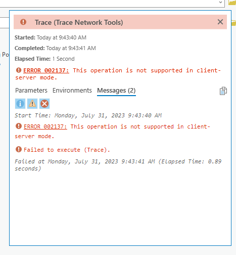

In addition, if use as starting points an already existing shapefile, i find the following error:

I am not as familiar with the trace network as I am the utility network, but I think they have the same restrictions.  You must publish the trace network to a feature service to trace and edit once versioned.
