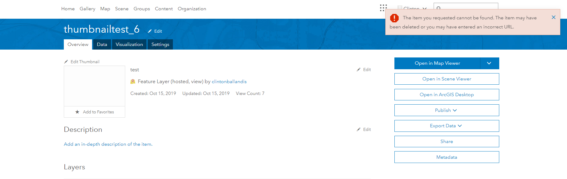

I'm having issues with thumbnails not being created in ArcGIS Enterprise 10.6.1. When I try to create a hosted layer view I get the following error
"The item you requested cannot be found. The items may have been deleted or you may have entered an incorrect url"

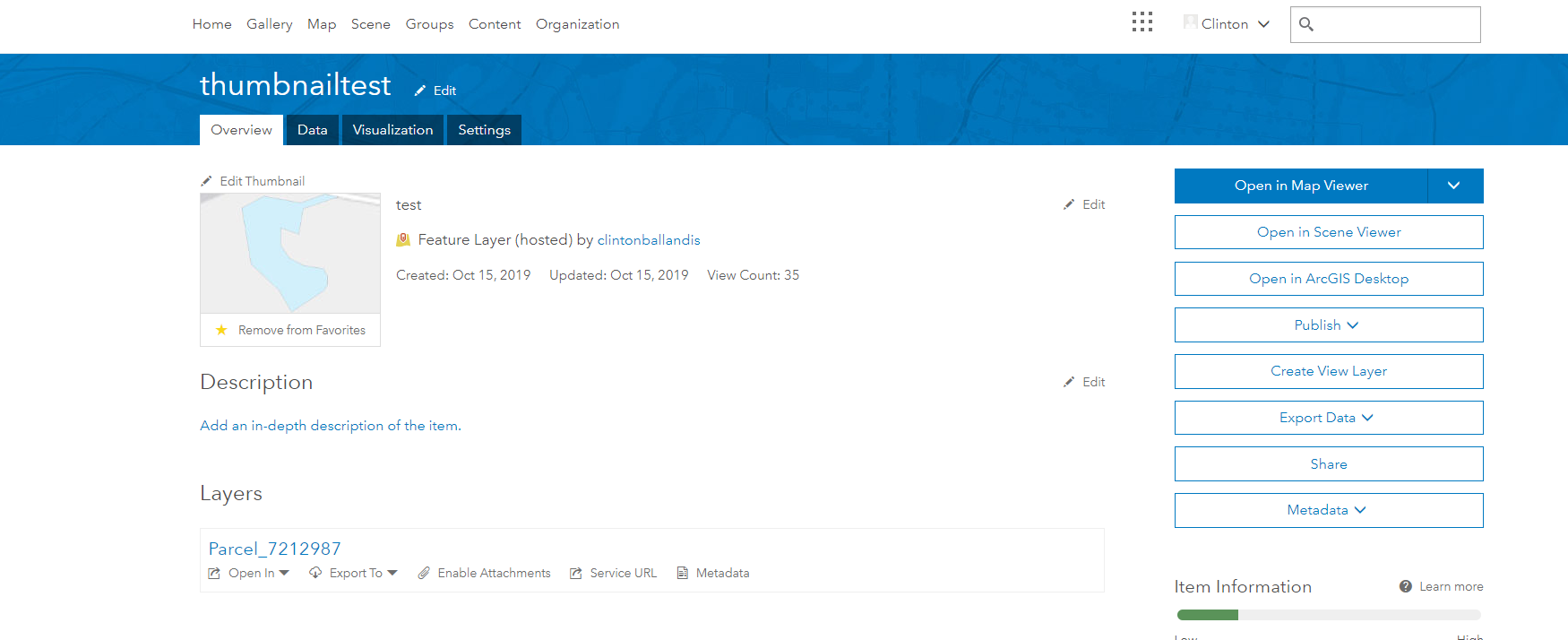

The thumbnail preview is also blank as per the Figure 2 below. It seems that the existing thumbnail from the source layer (Figure 1)  isn't being carried over to the hosted view or a new thumbnail can't be created for some reason.
I also get the same error if I try and publish a hosted feature layer from pro without specifically creating a thumbnail prior to publishing.
The error stops being generated as soon as I add a thumbnail image or make a change and save the layer. It appears to that saving automatically re generates a thumbnail.
                                                                        (Figure 1 Source Hosted layer)
                                                                          (Figure 2: Hosted Layer View)

I managed to resolve this issue. It looks like something in the thumbnail process was trying to access the service infoitems (where the thumbnails are stored) for our basemap map layers. For some reason access to the infoitems was being blocked.
I ended up rebuilding our basemap webmaps checking that the infoitem was avaliable for each layer.
No more "The item you requested cannot be found. The items may have been deleted or you may have entered an incorrect url" errors.
