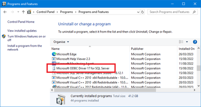

RedaAli
Sqlserver 2019
Yes I already have installed ODBC Driver 17 for sqlserver
