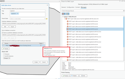

While we are trying to register the database on ArcGIS Server, we are facing the below issue. Meanwhile we are using Postgres as RDBMS.

Have you tried to create a new connection on ArcGIS Pro before publishing the data?
Have you validated the connection on ArcGIS Server? Like Server Manager > Site > Data Store > Validate

I tried for new connection and validating the database connections in ArcGIS Server but still i am facing the issue.
sapnas
What is your server name? If you are unsure on the machine name then use your ip address. localhost stands for local computer.
WellingtonChristian_Rodrigues_
Based on your string connection we need  to now:
Where is your AGS?
Where is your data base server?
Where is your ArcGIS Pro?
Did you check your firewall?
