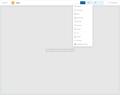

Thanks for the quick reply. Here is what I see when adding new components to my dashboard. I don't see the table option?
Strahanjen
Sorry, I just realized that I was mistaken about the version. This server is still at 10.9.1. I'll upgrade.
David_McRitchie
Hey Strahanjen,
Ah that explains ,I had checked this on Enterprise 11.0. The table widget was released at this version. Please let me know if you get any issues after your upgrade.
