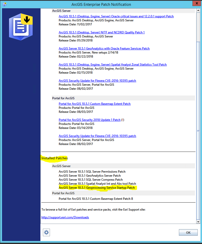

I think we have all the patches that may effect this install (the GP one).  I see there is a Basemap patch for Portal, but again, this is ArcGIS Server, non-federated, so I do not think that applies.  For the record,below is the result of "check for updates"
Any help is appreciated.  Thanks
