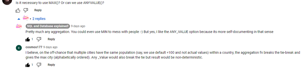

For what it's worth, I've been using Oracle's new ANY_VALUE() aggregate function instead of the MAX() aggregate function:
ANY_VALUE(CITY) KEEP (DENSE_RANK FIRST ORDER BY POPULATION DESC)
Reason (from a colleague):
Knowing that you have max(city) there but that it will actually ignore that and get the city for the one with the highest population because of the KEEP seems counterintuitive.
While ANY_VALUE() will be "ignored" as well, at least it is more self-documenting. It suggests that the real logic  is in the other keywords:
... KEEP (DENSE_RANK FIRST ORDER BY POPULATION DESC)
Related comments about ANY_VALUE()https://stackoverflow.com/questions/65866812/explanation-of-keep-in-oracle-first-last/65868727?nored...
Comments in the original YouTube video:
db-oriented.com: ANY_VALUE and FIRST/LAST (KEEP)
