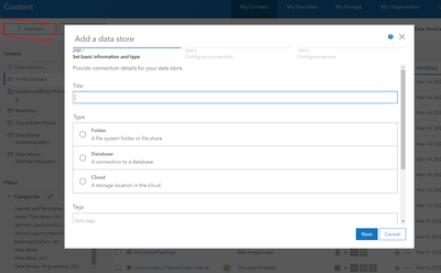

When you say your database is registered, do you mean in the server manager, or have you gone through the process of adding a data store as an item in Portal itself?

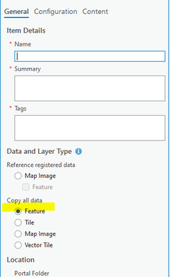

As to your second question, when sharing a web layer, you can copy the contents to your web server by selecting "Copy All Data:"
That wont save it to your SQL Database though, for that you'd need to export the layer to a geodatabase feature class.

Hey.  Registering the SQL Server as a datastore doens't put it into Portal, as such.  The datastore is like a 'check' to make sure that your ArcGIS Server can communicate with a database.  Once you've created the data store registration in Server Manager (or Portal) you need to author a map in pro, and then share that as a Web Layer, and specificlaly as a Map Image Layer.  Once, the Map Image Layer is published, then it will be available to Portal.
