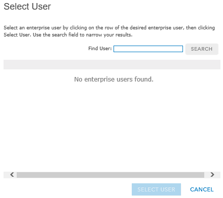

However, when I try to add member in Geoportal (Geoportal -> Organization -> Add members -> "Add members based on existing enterprise users", there is no users come up. The list is empty. Here is the picture :
it turns out that even-though it says "successful" during the Update Identity Store, it is actually not able to connect to the identity store. There is error when I try to search users in Get Enterprise User (portaladmin -> Home -> Security -> Users -> Get Enterprise Users) that says :
"Error
[LDAP: error code 1 - 000004DC: LdapErr: DSID-0C0907C2, comment: In order to perform this operation a successful bind must be completed on the connection., data 0, v2580]
It seems to me that I need to bind it correctly first before able to list all the users.
Any idea on how I should fix this problem ?

I cant even connect. But, never mind. Problem is solved now. Checkout my reply.
yockee
Here is the correct configuration thats working :
  "type": "LDAP",
  "properties": {
    "userPassword": "v24qDsZ1bH2U1cUst7n0Ng==",
    "userEmailAttribute": "mail",
    "usernameAttribute": "cn",
    "user": "sAMAccountName=MY Name,OU=XX,OU=User Accounts,OU=X,OU=Y,DC=Z,DC=com",
    "ldapURLForUsers": "ldap://LDAP-address.com/OU=User Accounts,OU=X,OU=Y,DC=Z,DC=com",
    "isPasswordEncrypted": "true"
In LDAP, I can trace my user name by following this path : "CN=MY Name,OU=XX,OU=User Accounts,OU=X,OU=Y,DC=Z,DC=com". This is, probably 95% sure, is the path that you should type on to the "user" parameter part. I remove some parameters as well, like : "caseSensitive" and "userSearchAttribute".
