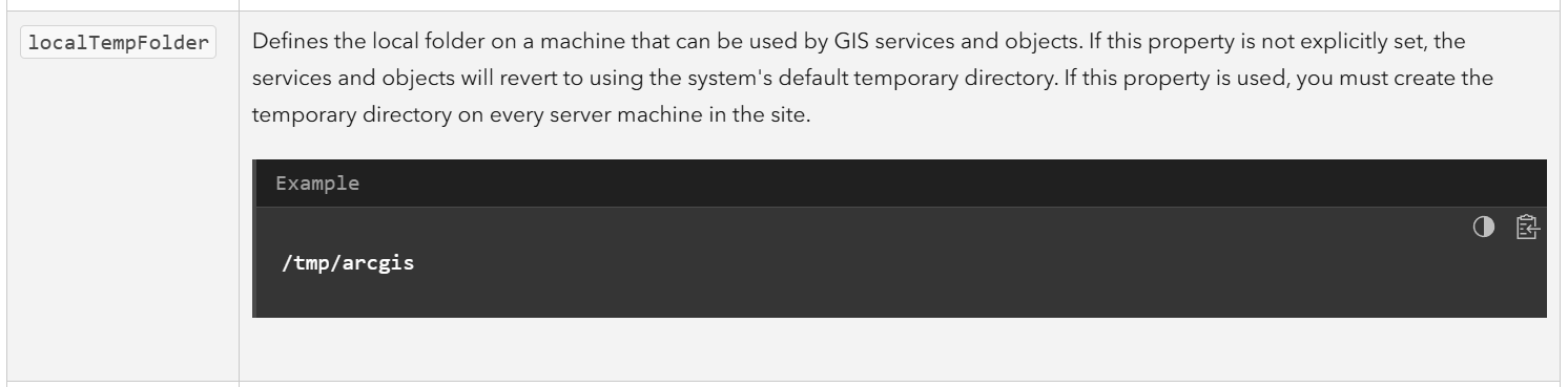

The ArcGIS Server Properties contains a "localTempFolder" parameter that seems like it should override windows user temp defaults. I can't get the WebGIS DR process to write to this directory when localTempFolder is set.
I have tried this path using the following with no luck:
{"localTempFolder":"E:\\arcgistemp"}
{"localTempFolder":"E:/arcgistemp"}

This has been confirmed as a bug in ArcGIS Server. Esri have updated the following bug to indicate this is still an issue at 11.1 and that it applies to WebGIS DR Backups as well as Image Server issues: BUG-000122129 for ArcGIS Image Server
Until this issue is resolved, the workaround is to edit the AGS Service Account user's temp directories as in this workaround: https://support.esri.com/en/Technical-Article/000018777
