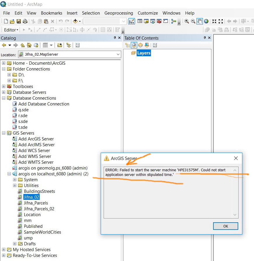

As I started the service, I got the message below
However, all what I did is uninstalling\reinstalling the ArcGIS Server and that seemed to resolve the issue.
But what if I had a looked at Home > machines > HPE31575M > status? How this could help in resolving the issue?
I don’t think that I had a permission issue here as this is a test stand-alone machine where the ArcGIS Server used to work fine for more than a year with no issue. Suddenly, I got the error that I highlighted
