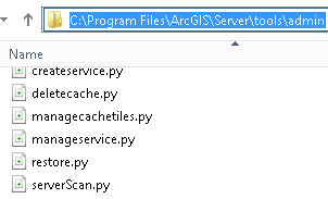

Glad that worked for you.  Additional thought: Have you run portalScan and  serverScan?  These are in the tools folders at your Poral and Server installed location.
Here's the default location on a Windows server
