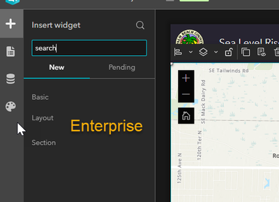

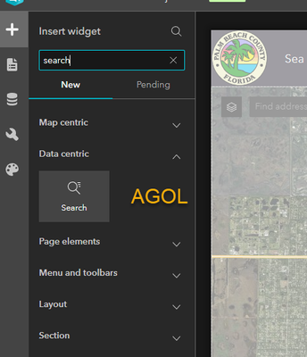

So,  we are moving over to enterprise and I was having the same problem.  I'm sure, since we just implemented enterprise 2 weeks ago, that we have the latest version (I see this post was in May of this year).  I wanted to add a search widget to my map, which was available on AGOL, but it doesn't seem to be available in enterprise.  See below:
There seem to be a lot fewer widgets in enterprise.  Does anyone know why this widget isn't available? You would think that "search" would be a basic widget that would come out in the first build.
