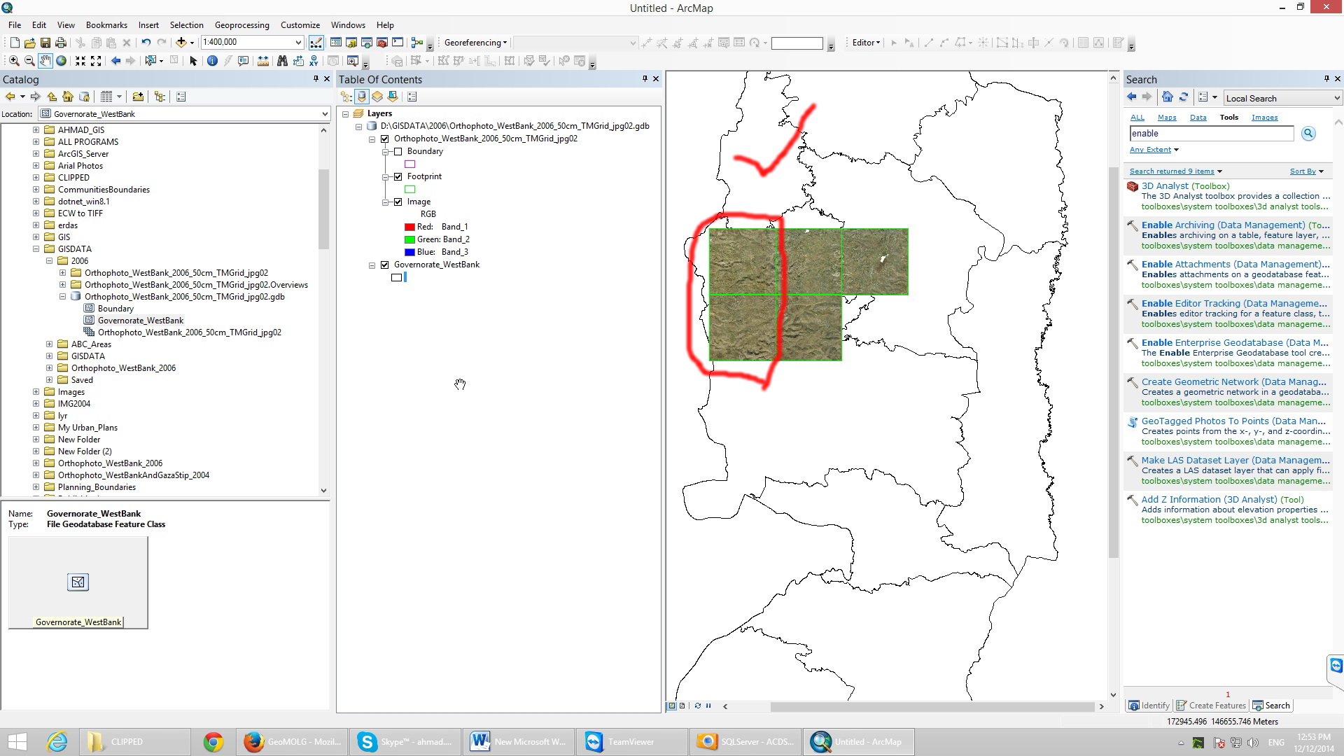

Please, consider the following scenario:
  1. The following mosaic dataset contains 3 images in it, it was published as a service and cashed, and it works fine and many organizations read from my server.
    2. I need to add 2 more images to the same mosaic dataset, so the shape of the new published service will be similar to the screenshot below.

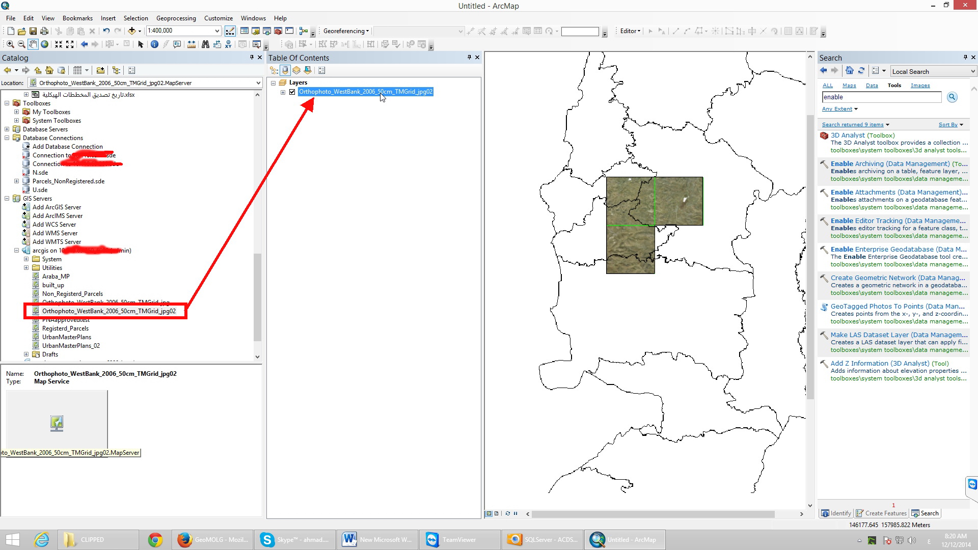

Now my question is what is the best practice to update the old published service such that the new one reflects the change in the mosaic dataset and shows the 5 images?
Note that I want to publish it with the same name in order not to interrupt the other organizations “not to change the link to this service in their web mapping applications”.
Thank you
