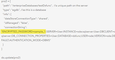

Q3. Where does the variable sample_1 come from in the linked python script?
Q3. How do we encrypt the password?

The step missing between 3 and 4 of the documentation is to create the SDE file, which requires the arcpy library's CreateDatabaseConnection function.
arcpy.management.CreateDatabaseConnection(out_folder_path, out_name, database_platform, instance, {account_authentication}, {username}, {password}, {save_user_pass}, {database}, {schema}, {version_type}, {version}, {date})
At this time, there is no method to directly generate the ENCRYPTED_PASSWORD, nor to do it without invoking the arcpy library.  I have created a related Enterprise Ideas post recommending that there should be one for exactly this use case.
