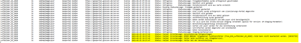

But when I want to share the layer as I did before I get after about 12 h the following errors in the log:
2021-02-26 11_29_08-SharingJobLog.log - Editor.pngHere is the full log:
2021-02-26 11_26_39-SharingJobLog.log - Editor.pngI am wondering why the first layer with just 10 orthophotos were published successfully and now publishing the layer with ~390 orthophotos fails.
Any ideas?
