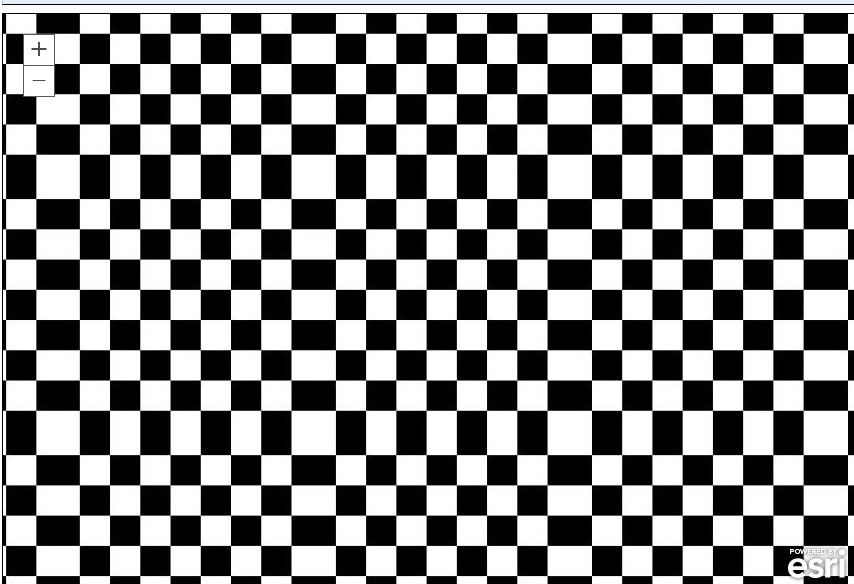

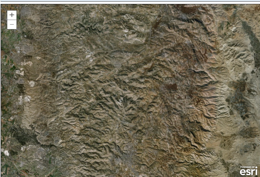

I’ve published an orthophoto via ArcGIS Server, but after viewing the service, I figured out that there is a problem with viewing the service at large scales; when zooming in, the orthophoto disappears and the map becomes full of black\white squares (in the screenshot below). What might be the problem here?

1- At small scale
2- when zooming in to larger scale, everything disappears, and I get this:

At what scale is the issue arising? If you have created tiled cache, check what is the scale of your highest level cache?

It would also be helpful to know what version of ArcGIS Server you are using, and it was cached at the same version (if not, what version was used).  Did you use the normal "expanded" cache or the bundles (note: bundles in 10.1 vs 10.2 vs 10.3 are all different).  If expanded, you can go to the folder containing the cache, look at the scale level and see if the cached image is correct/exists.
What was your source for tiles (e.g. tif).?  Did you use a mosaic dataset with Image Server extension?
I have seen this issue before, and typically it was because I was trying to cache a cache (was able to do this in 9.x or 10.0 for older datasets I was trying to reproject....don't try this at home ).  It could also be caused by running out of temp space (C: drive) when running your cache process.
Or to add to what Jayanta mentioned, it could be trying to zoom into a scale that maybe valid for the service, but you have "cache-on-demand" turned off, or turned on and the client handled it incorrectly.
What client are you seeing this with?   ArcMap, ArcCatalog, or a web app (and which API/type)?
Sorry for all the questions, but sometimes more info is needed to know the cause (so many variations out there).

The problem appears at scale 1:24000,

This issue usually occurs when the source imagery cannot be accessed.  When you load rasters into the mosaic dataset, make sure you are using a UNC path.
What is happening is that the ArcGIS Server instance is accessing the mosaic dataset.  At small scales, the overviews are returned.  When you zoom to a large scale, the raw imagery is returned.  If ArcGIS Server is installed on a different machine than the mosaic dataset, the service looks for the imagery according to the path of the rasters (i.e. C:\data\rasters).  If you load the rasters with a UNC path, the ArcGIS Server instance knows which machine to find the rasters (i.e. \\rasterserver\data\rasters).

Actually, the source data is stored locally on the same machine the ArcGIS Server is installed

Also, make sure the ArcGIS Server Account (i.e. arcgis) has read privileges to the rasters.
