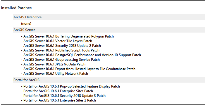

Last Friday we installed Enterprise Sites 2 Patch on our 10.6.1 ArcGIS Enterprise instance and now it seems to be broken.
We have Portal and Server federated and Data Store. All software are installed in the same server machine on our network.
We use two different Web Adaptor one for Server (named: server ) and one for Portal (named: portal).
The patches  we have already installed are:

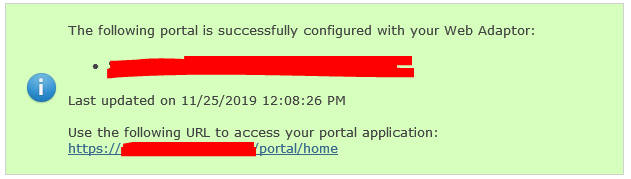

When I look at webadaptor configuration in the HOST machine all seems to be OK
I also try to reconfigure the web adaptor but with no success.
