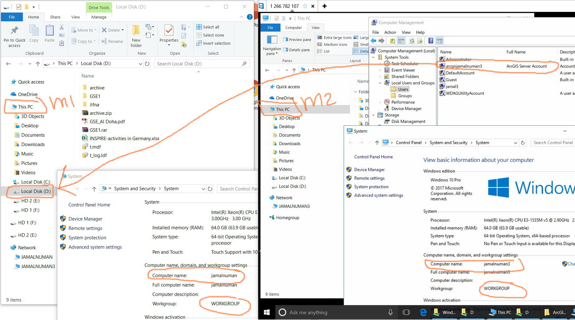

I have the following case:
The data is stored in machine (m1) and the ArcGIS Server is installed in machine (m2) where these two machines are on the same group.
How the ArcGIS Server User Account in machine m2 can have an access to the D drive of machine m1 (whew the data is stored)?

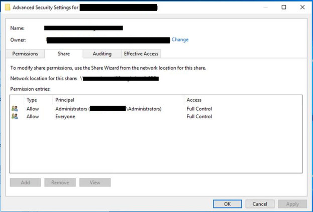

@DanielLewis ,
Try this, go to properties of the folder > Security > Share and try sharing the folder with Administrators first then try to create the datastore (ArcGIS Server Manger > Site > Data Stores > Register Folder). If it doesn't work, try to share with Everyone. Then register the folder.
I hope that helps.
