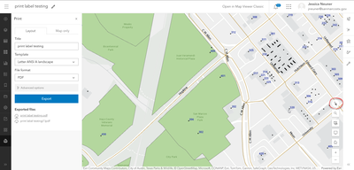

  • when the map is rotated -- those labels look great in the web map. they rotate just fine
  • BUT - once the map is printed, they might be upside down
Here's a simple example of my rotated web map -- labels looking as expected --

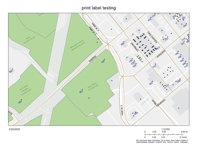

and the output pdf from the print request, everything is upside down.
Is there a setting in the print service or map service that would queue the map service to get those labels to align with the rotated map frame in the export web map request?

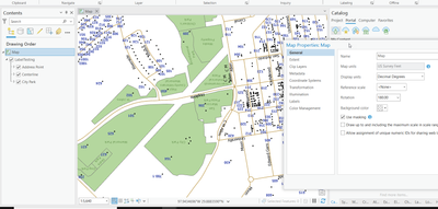

Out of curiosity, brought the map service into Pro to see what happened if I rotated the map frame... and the labels didn't right themselves, they were upside down.
Not quite sure why they are right side up in a web map, but not in Pro.  Incidentally I brought the web map from the original test into Pro -- and same thing, the labels were upside down.  Still a little puzzled, but does seem like a limitation of the map server?
