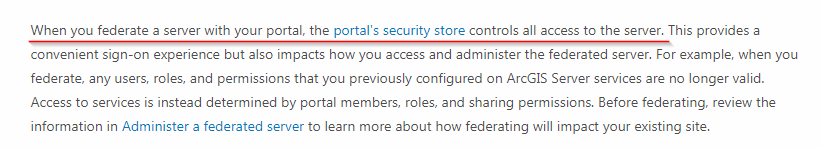

Federating basically means that you are relinquishing all authorization checks to Portal (sharing models and integrating security). (among other things, such as now requiring named users etc) so yes, it would direct you to portal for authorization credentials.

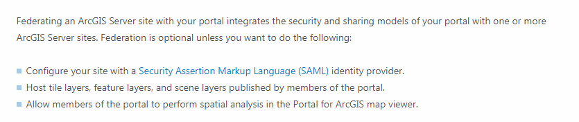

As per documentation, Federation is optional except if you want to do the following:
If your workflow doesnt include any of those three bullet points, then I would re-consider federating at all.

Also as per documentation...
Ref: Federate an ArcGIS Server site with your portal—Portal for ArcGIS (10.5.x) | ArcGIS Enterprise
