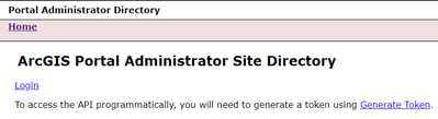

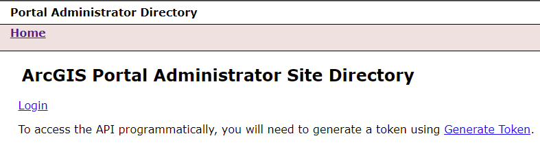

When I go to "https://portal.host.machine:7443/arcgis/portaladmin/" I see below screen.
I have tried on different browser (Edge, Firefox, Chrome, IE), same result.
I have no error in the portal logs.
Do you have any idea to solve the problem?

If you are able to get to the page shown in your original screenshot, then you are able to get to /portaladmin.  10.9 /10.9.1 changed the landing page, and there is now a login button (upper left, under the bold text), instead of the form for entering a username / password.
