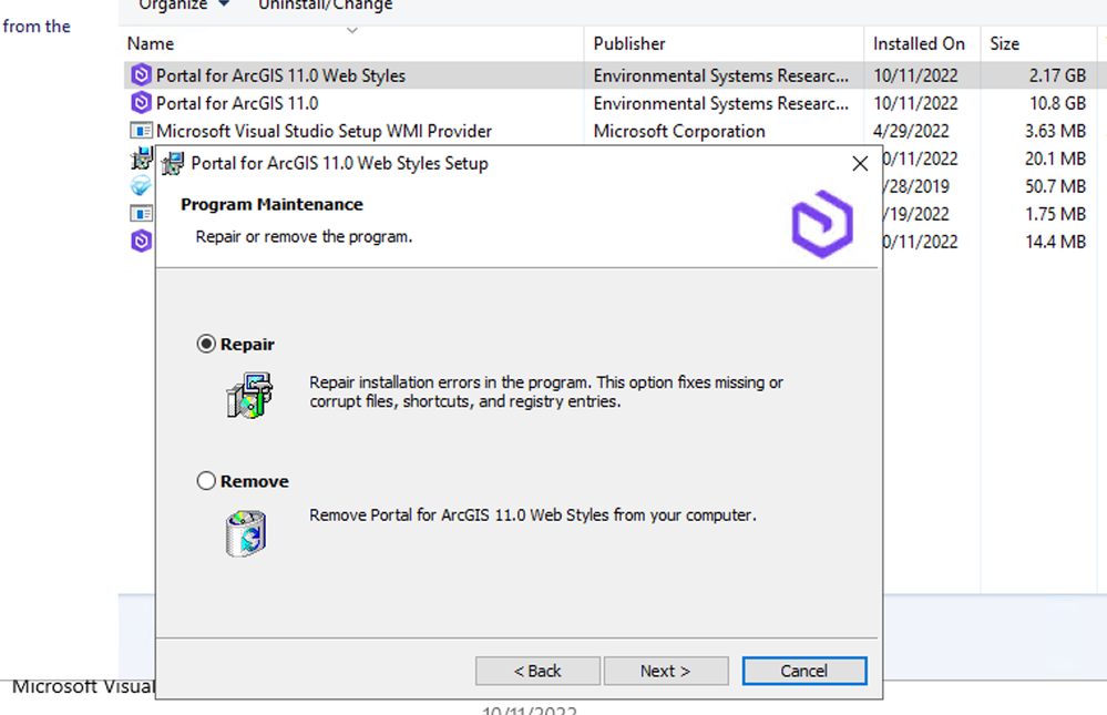

Where is the portal "repair" tool you used located?
NicolasGIS
Honored Contributor
Standard Windows "Program and Features" of the panel configuration, select Portal Web Styles Uninstall or change, and select "Repair"
anbinh
Hi guys,
Finally I've got a chance to run the portal repair in my client's environment, and it has successfully fixed the portal 3D webstyle issue I had. Thanks all for your help, I've taken Nicolas' answer as the solution.
