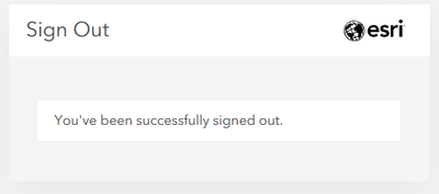

I noticed the following: "Propagate logout to Identity provider" only works if logged in directly on Portal for ArcGIS (ie: OAuth client id  ="arcgisonline"). If you are logged in on Portal for ArcGIS through an OAuth application (ie: OAuth client id  ="o8WEYheNpQcE2dwwh"), then when signing out from another application, Portal for ArcGIS does not propage the logout and instead displays the following window:

Now, let's compare it with the broken scenario:
2. Broken scenario when logged in indirectly on Portal for ArcGIS through an OAuth application:
User is logged in on Portal for ArcGIS indirectly through an OAuth application and on sp1.example.com and the user request a global logout from sp1.example.com. At step 3, Idp make a POST to sharing/rest/oauth2/saml/signout but this time the reply is the following:

which ends up to the page "You have been successfully signed out".
