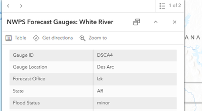

Can you provide screen shots of your data? And do you want to show the fields as a comma-separated string ("Field1, field2") or a field list like this?

Preferably I like to show the fields in table format, like your screen shot. Different provinces show respective values in different fields  in my data; that is why I need to customize it to show different fields for different provinces.
