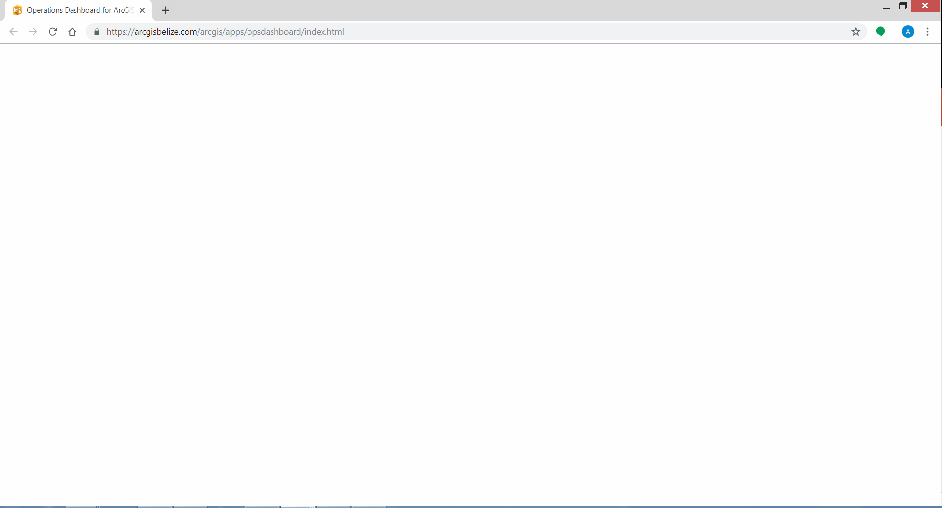

Our team has recently begun testing with ArcGIS Enterprise and have configured a base deployment of ArcGIS Enterprise 10.7 using a cloud server. In our testing and validation, noted that Operations Dashboard does not want to open. We have tried various methods to start Operations Dashboard through Portal. To give you an idea of what we are encountering, we had created a web map using a feature service hosted from Survey123. After choosing to share as an Operations Dashboard and inputting the title, tags, and summary, a blank page opens with no options (screenshot attached). We have not been able to find any documentation on this. This is also true for Sites (these are the only 2 in the App Launcher). Any assistance in helping us to understand this issue would be really appreciated.
Hussam_AlJabri
Update:
The issue came again and after checking the /portaladmin I found that the portal name was coming as (Server Machine name) in the javascript. I added a setting in the Portal called WebContextURL and that resolved it.

Hi Antonio,
> We have tried various methods to start Operations Dashboard through Portal. ... a blank page opens with no options
We haven't seen this behavior with Operations Dashboard in Portal for ArcGIS 10.7 before.
> This is also true for Sites ...
By "Sites", I believe you mean 'Enterprise Sites', correct? This sounds like there might be an issue with your ArcGIS Enterprise deployment/installation. I would verify that your Enterprise Base deployment is installed and configured correctly.

Thanks for the feedback. We had proceeded to upgrade to 10.7.1. Internally the apps are working now, but externally they fail to load when launched. We are making some adjustments tand reconnecting our web adaptor and hosting server, and will see if those changes solve the issue.
-Antonio
GarethBaker1
We've just upgraded from Enterprise 10.6 (where Ops Dashboard was a separate installer) to 10.7.1 and are experiencing the same problem. Can't open or edit any dashboards when accessing our Portal via our web adaptor and externally visible domain name - goes to the URL but just a blank screen, same in IE and Chrome. If I go directly to the server then I can at least get a dashboard to open, the elements load but they don't seem to be able to access the source data.  We have got an issue with our ADFS access post upgrade at the moment which we working on resolving so fingers crossed that may also sort out the dashboard access. Will post an update when we know more.
GarethBaker1
Weirdly seems to have now sorted itself out and dashboards seem to open up just fine. Perhaps some sort of browser cache issue?
