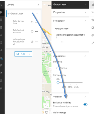

You might be interested in exclusive visibility in a group layer ?

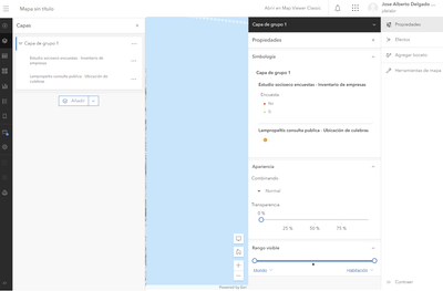

What version does the map viewer use? I use Enterprise in version 11.1 and that function does not appear.
Regarding the visibility of layers it only allows me to manipulate the visible range

Exclusive Visibility will be available in Enterprise 11.2
