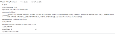

I am facing a problem with rest requests with ArcGIS Server 10.6 on a map service when feature classes are stored in a SQLServer geodatabase.
The max reccord count returned by the service is set to 1000.

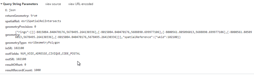

For instance, my rest requests have the following parameters with the resultRecordCount set to 1000:
However the number of features returned by the request is less than 1000. It could be 991, 995, etc...  it seems to be random.
