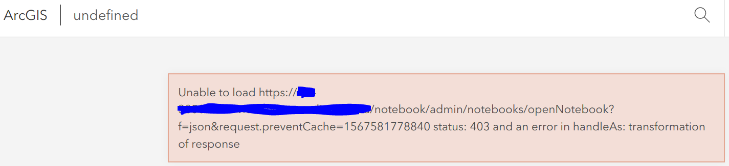

I just installed ArcGIS Enterprise 10.7.1 with the Notebook Server. Docker Desktop is running and I also downloaded and pulled the esri docker images (Advanced and Standard). The server is also federated and designated. However, when I click the Notebook on Portal for ArcGIS, it throws this error (screenshot below):
I also added a notebook from Add Item, same error. and when I'm going to create a notebook via Create button in My Content, nothing happens. Any ideas?

Hi Mehdi,
Are your Portal environment and your Notebook Server configured to use a Domain certificate or a certificate signed by a trusted Certificate Authority (CA)? The default self-signed certificate that is pre-configured with Notebook Server is only intended to be temporary, to test the server connection and verify that the installation completed successfully.
For more information, see: ArcGIS Notebook Server system requirements—ArcGIS Enterprise system requirements | ArcGIS Enterprise / Section: SSL certificates

Hi Rachel,
I've configured the Notebook Server with Portal to use a Domain certificate. I've also federated the Notebook Server and designated it.
