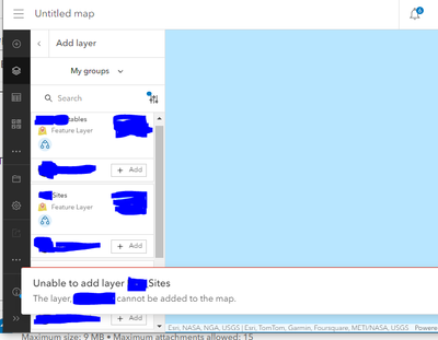

I set it up and I can see the layers shared listed in the Host (AGOL), even when I try to add it to a map they are there.
The issue is: the data is not accessible both from within or outside the network.
So there is still something I have to do in the system to make the data available I guess.
